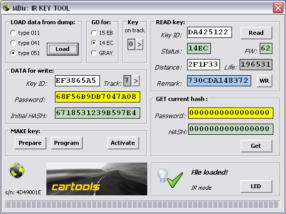

MBir: MBir software
what’s new:
- allows to make 2nd and 3rd key on track, not only first (tracks are numbered from
0 up to 7, on each track there can be 3 keys (0,1,2). If key 0 on selected key track
runs out of life, it can be replaced with key 1 and so on.
- added BE key support - write and “reset” to 21DF is now possible.
- improved GRAY key reading and writing
notes:
- BE key can work only as a first key (number 0) on track.
- if you are looking for direct BE key EEPROM reading and writing, you must purchase
additional software module. More info…
- according to practice always check if BE key is working properly, compare hash it
send out with generated hash list. You can generate it with MBhash software. In
- not working radio on BE is not a problem of key writer. It’s a bug of key itself.
